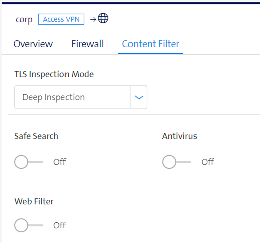

Configuration option TLS Inspection​
  1. For Security go to Outbound Links / Content Filter
  2. First, select TLS Inspection Mode because this selection affects other options such as "Anti-Virus" and Web Filter. Choose between Deep Inspection Mode and Certificate Inspection Mode.

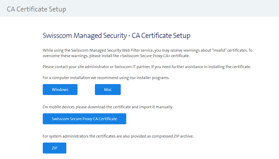

Configuration: Install SSL Certificate for Deep Inspection​
  • To check the encrypted web traffic, the web filter decrypts the connection and encrypts it with the Swisscom Webfilter certificate.
  • The Web Filter Gateway Certificate can be downloaded from this website.
  • Attention: To download the certificate, you must be on the LAN where the web filter is enabled.
  • The file can be installed on the device (laptop, tablet, etc...) by a user who has local administrator rights on the device (e.g. for Internet Explorer).

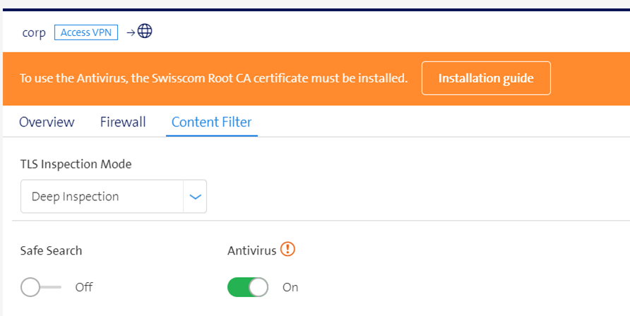

Antivirus​
  • The Antivirus option scans the contents of web connections for known virus patterns.
  • It can be activated in the dashboard under Managed Security > Outbound Links > Content Filter.
  • For the Antivirus option, the certificates must be installed and Deep Inspection enabled to verify encrypted connections.
  • Once you enable Anti-Virus in the dashboard, you will be prompted to install the certificate on your devices.
  • Click Installation Instructions to get step-by-step guidelines for installing the certificates on your devices.

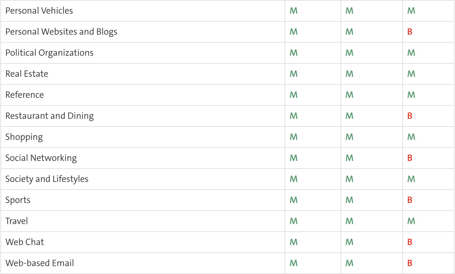

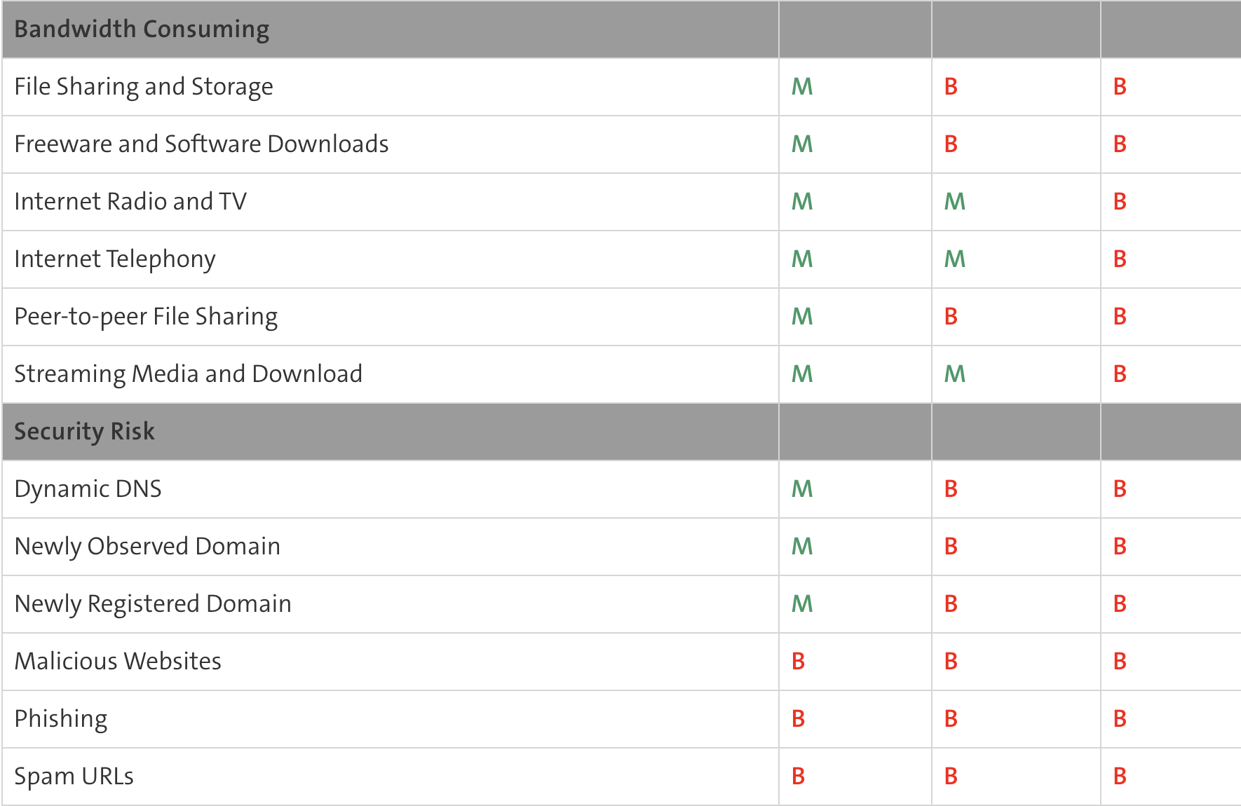

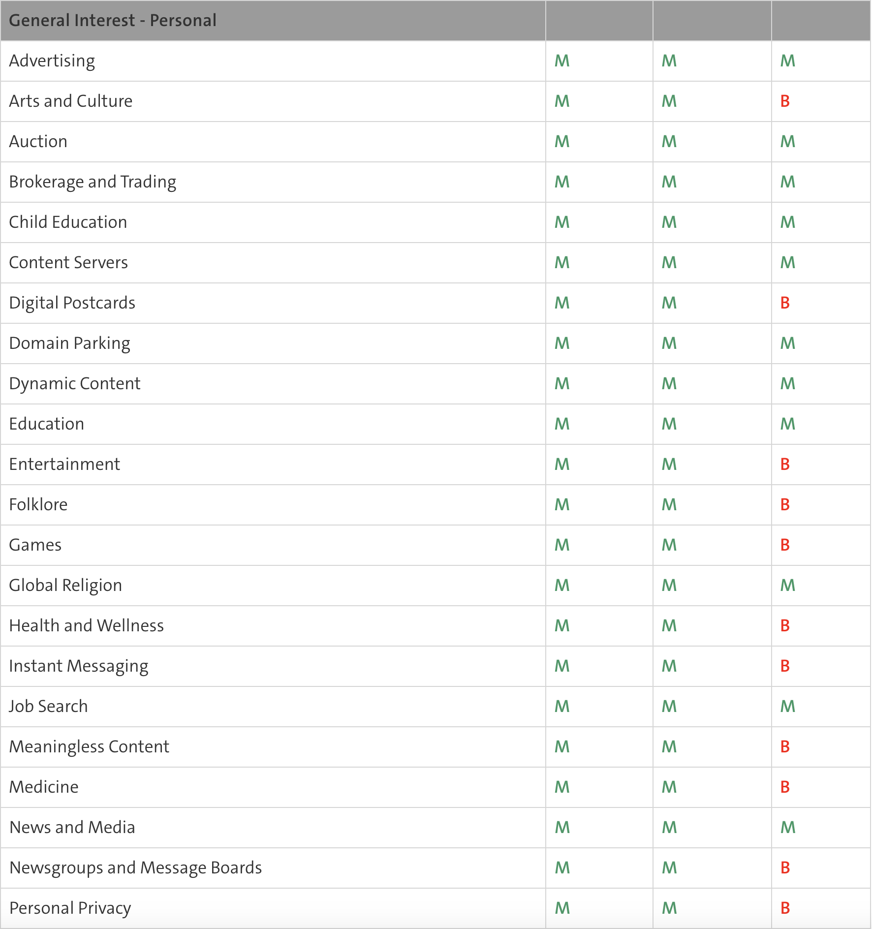

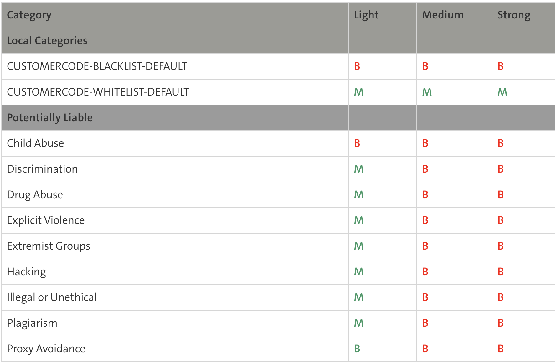

Web Filter​
  • The Web Filter option requires the certificates to be installed to verify encrypted connections.

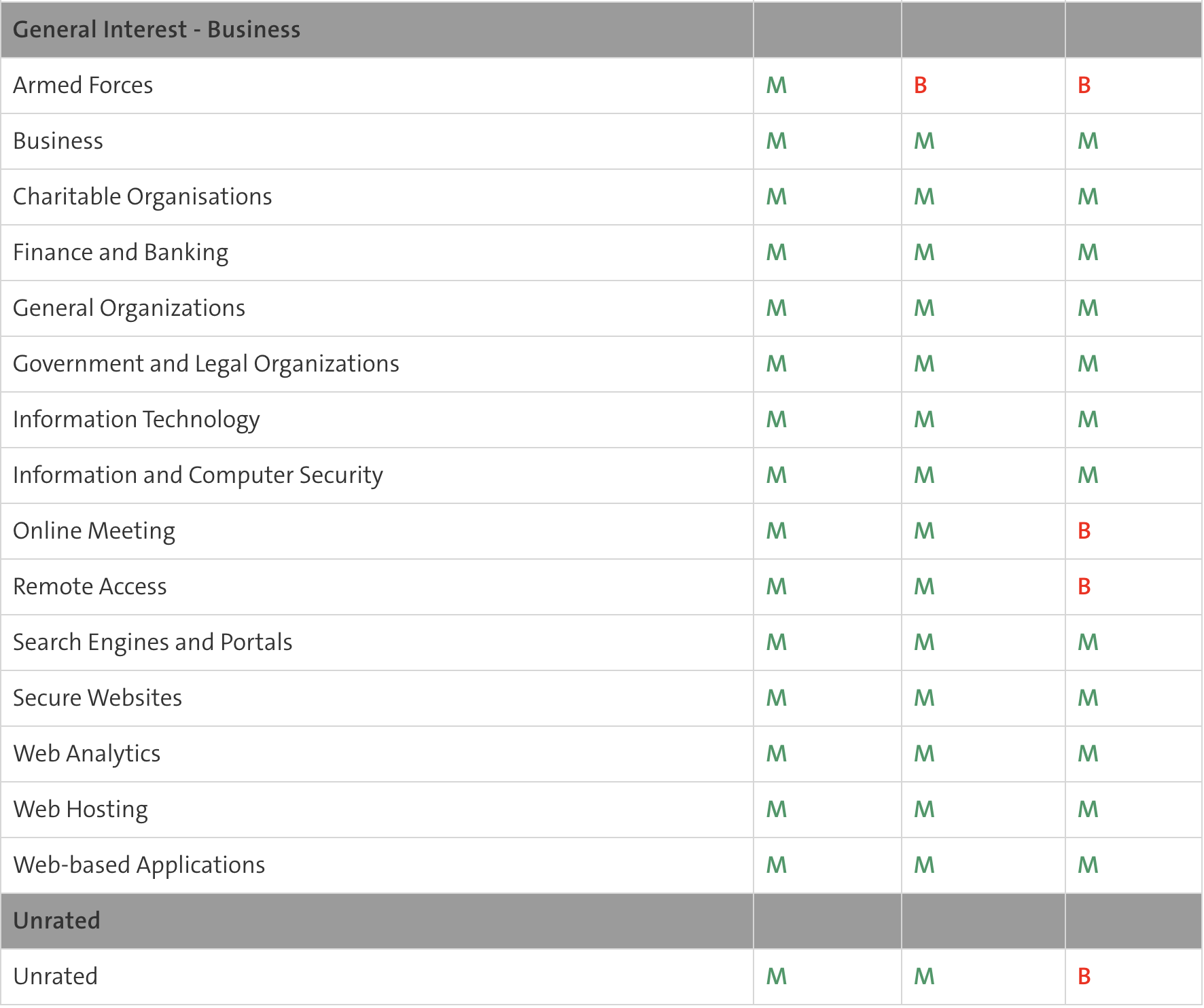

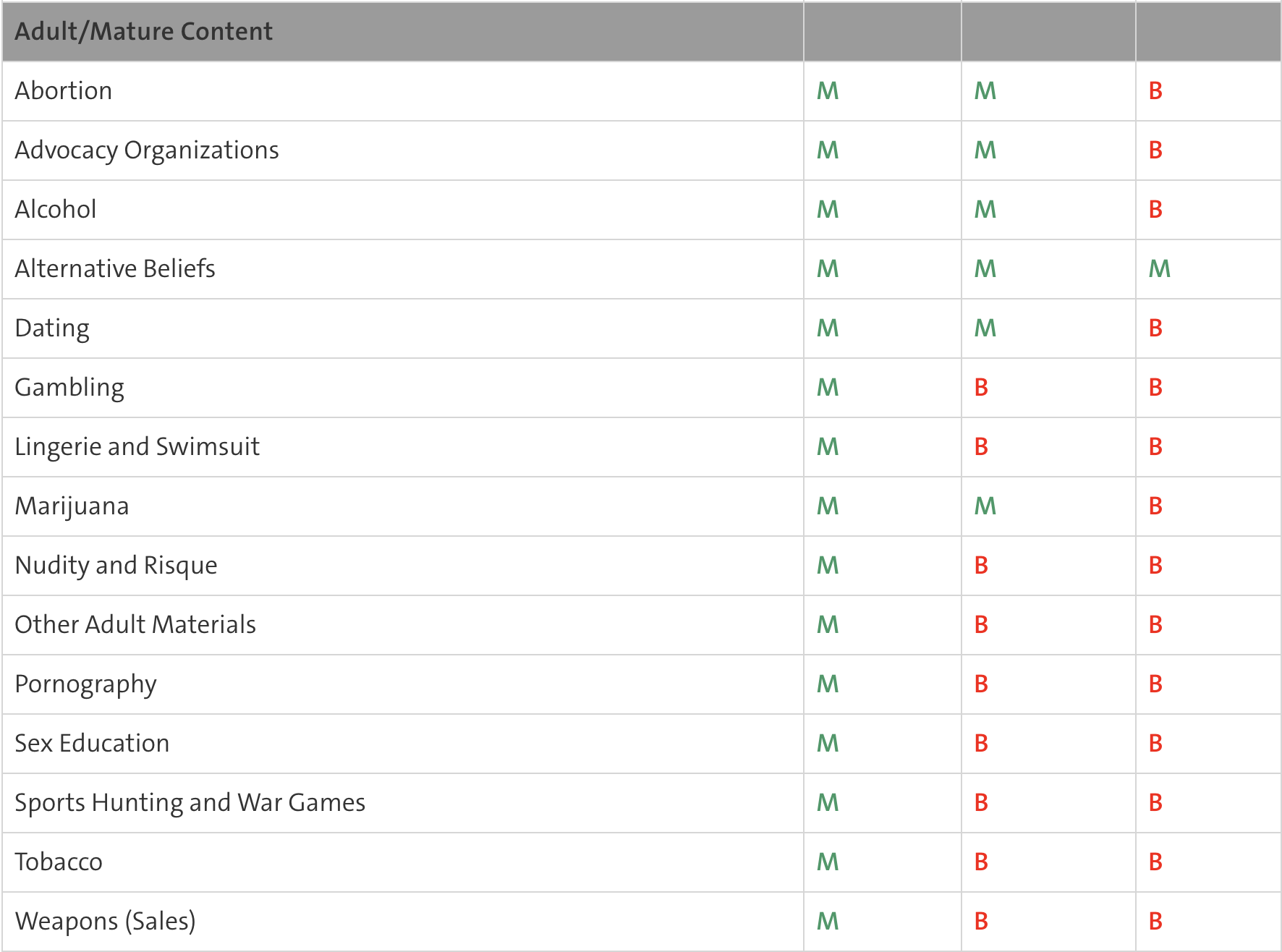

  • Here you can select one of the three web filter level templates, Weak / Medium / Strong.
  • The predefined Web Filter Ruleset templates are listed in the table below (A= Allow / B=Block / M=Monitor)
B: Traffic is blocked by the web filter. M: The traffic is monitored and is visible in the report. A: Traffic is not monitored and is not visible in the report.
plot plot plot plot plot plot

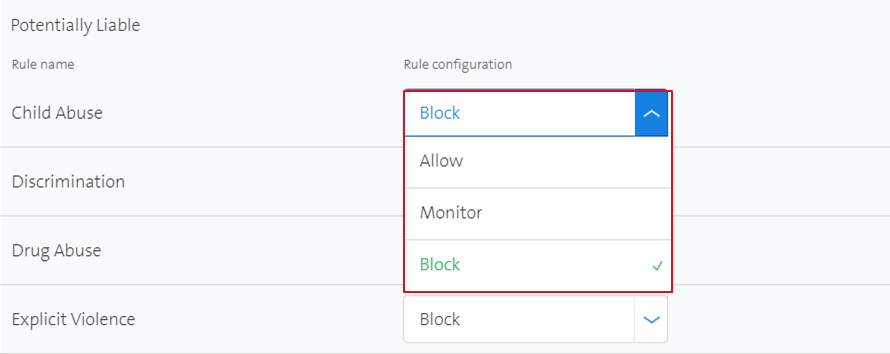

Webfilter Ruleset​
  • The Web Filter Ruleset can be configured individually in each subcategory based on category.
  • Websites of the categories, Banking / Health and Insurance are excluded from the web filter and are not monitored.
