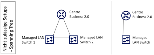

  • Aruba Switches Spanning Tree is always activated on the Aruba switches, but not on the Centro Business 2.0. Therefore, the following configuration/connection is not allowed:
    • Switch-1 to CB Port 1
    • Switch-2 to CB Port 2
    • Connect Switch-1 and Switch-2
